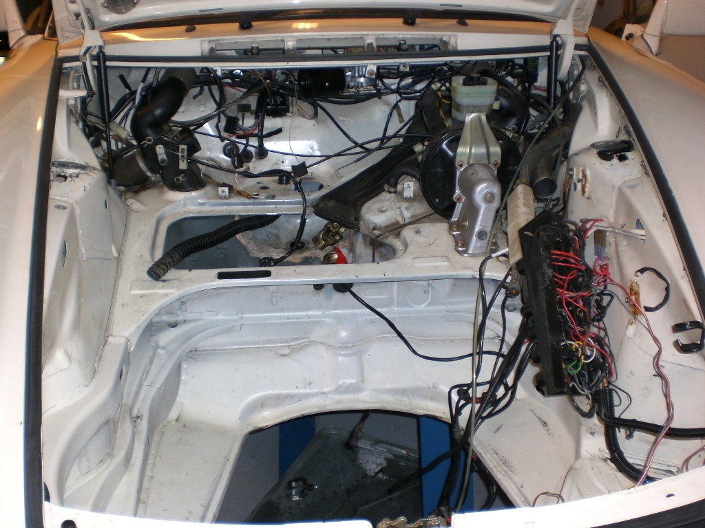

In the front of the car, I removed the rest of the strut tower bushings and cleaned off all the black goo Porsche puts up there. I also removed the fresh air blower to (1) get access to the m/c (2) do something about the fan that doesn't work and (3) remove the factory alarm module before it craps out and strands me (it's tied to the DME relay). I also cleaned out the smuggler's box in prep for the new battery mount.
Attachment 5566
Nice, huh? BTW, having the feul tank out makes it really, really nice to work in the area in the rear of the luggage compartment. I stand where the fuel tank was and can access everything very easily.

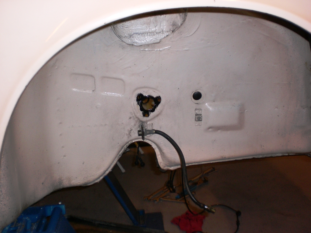

Here you can see I've also removed the brake line with the p/v that goes to the rear of the car. My new brakes don't use a p/v, so I'm replacing the whole line from the the m/c to the "L" coupler that goes to the back of the car.
BTW, if you are looking for replacement brake lines locally, ask for "European" brake lines, not "metric" lines. Despite the fact that they are, in fact, metric, the "helpful" guys at the FLAPS don't seem to know this. The tubing diameter is listed as 3/16", so they think it's a std size. It's not - it's a 4.7mm line with metric threads. And then ask for an ISO bubble flaring tool - the look that they give you is priceless. :roll:

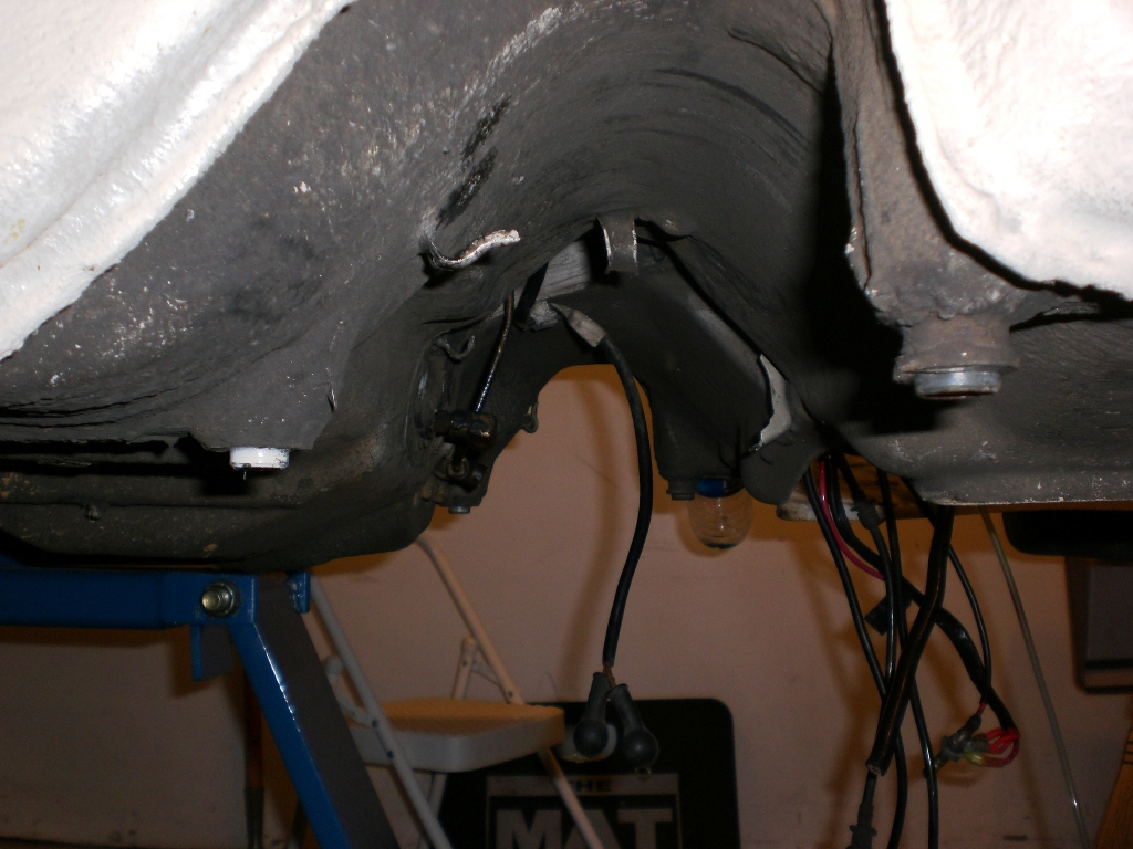

I got the front sway bar mounts drilled, aligned and POR'd. I also removed the brake wear sensor wires that I haven't used since the first set of "performance" pads I put on 3 years ago.
Attachment 5567

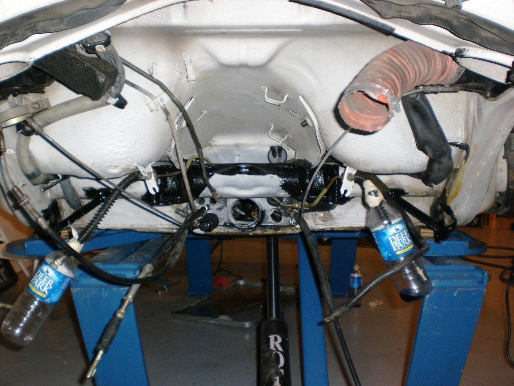

In the back, the engine bay is clean and I POR'd all of the areas with surface rust forming, esp the trailing arm mounts.
Attachment 5568

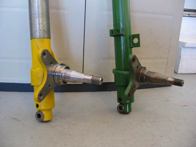

3. RSRs struts are lacking one minor detail:
Attachment 5655
There's no mounting tab for the brake line! Makes sense, clearly, since the coil over would get in the way... but goddamnit! One more thing to deal with. Matt tells me Porsche made a bolt on bracket for this, which I have been unsuccessful at finding. I thought about running a flex line straight to the caliper (using a banjo bolt), but was told by Steve Weiner to avoid this at all costs. It seems the flex line has a tenancy to get hung up in the sway bar and get yanked off :shock:. So today was spend at Home Depot and the FLAPS devising ways to build a bolt on bracket for this. I'd like to avoid welding so as not to ruin the coilover thread.
So tomorrow is fabrication day. I need to make a battery mount, a mounting plate for my kill switch, and brake line brackets. Then I get to make more brake lines. And finish cleaning up the wiring behind the blower fan and reinstall that.
Noah 06-16-2007 11:48 PM
For that brake line bracket on the strut, maybe you could use a heater duct clamp to secure it to the strut body. I'm going to have to tackle the same problem when I install my RSR struts, so definitely keep us posted on your solution...
