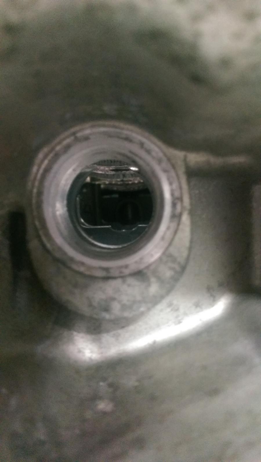

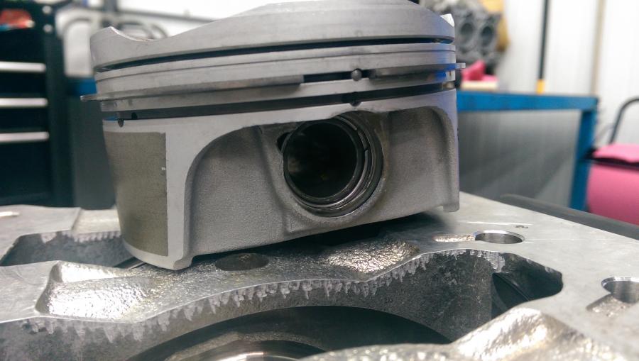

N0tt0N 12-03-2014 05:24 PM
2 Attachment(s)
Originally Posted by roundel (Post 502506)
uhg. I don't like circlips where I can see what I am doing. That procedure sounds scary. :eek:
Looks lined up way back in there....
Attachment 44108
Lets just reach in and pop the circlip on! Easy-peasy!
Attachment 44109
