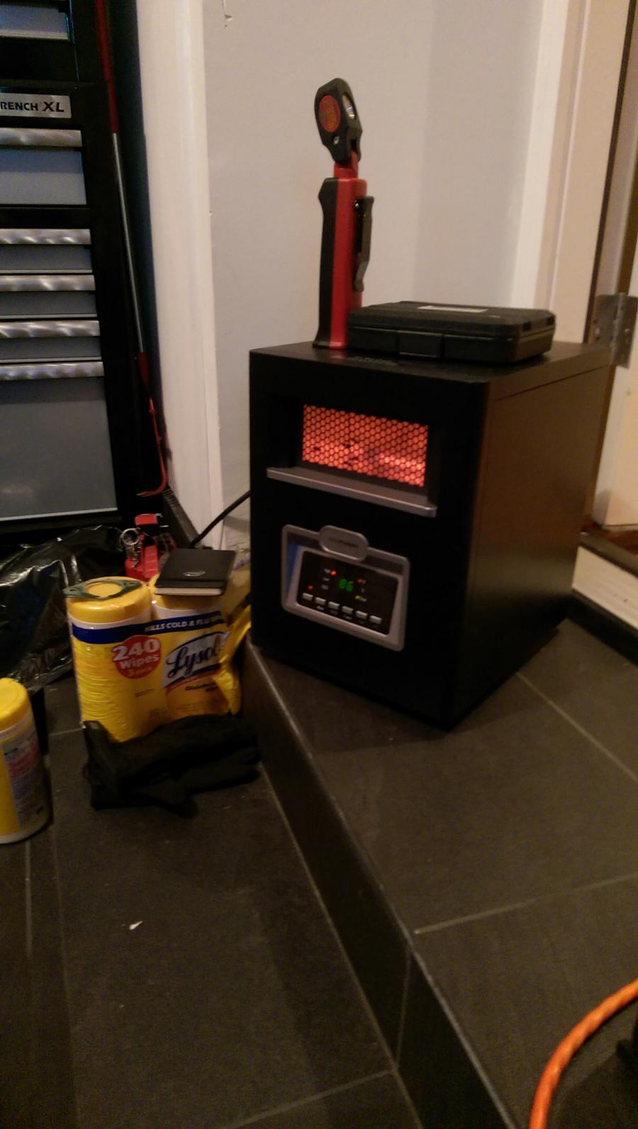

N0tt0N 02-01-2015 12:39 AM
Originally Posted by 987kmns (Post 508336)
Spent 30 minutes in the garage today, but got good value out of my time. At 30F, my hands were frozen stiff after about 10 minutes even with latex gloves on. Note to self - heated garage = mandatory.
I hear you. That's one reason I backed the car in this time and got this:
Attachment 45138
And floor mats. Cold to the bone on concrete or porcelain tile!
987kmns 02-01-2015 01:39 AM
That thing looks serious!
N0tt0N 02-01-2015 01:49 AM
Its actually small - no room for serious! Maybe 12" cubed, $100 buck quartz heater from Northern Tool. I'm sure a generic design. I was concerned it wouldn't work but its been fine.
