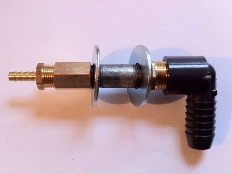

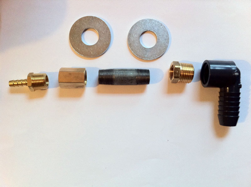

I went to home depot to get the parts to go through the walls of the cooler. From left to right they are:
  • 3/8" MPT to 1/4" barb
  • 3/8" FPT Coupler
  • 3/8 threaded pipe - 2 inch galvanized (Which is too long)
  • 3/8" FPT to 1/2" MPT - Reducer
  • 1/2" FPT to 3/4" barb 90 degree elbow
  • 5/8" cut washers
http://dorkiphus.net/porsche/attachm...chmentid=27550
Here is a dry fit of the assembled components:

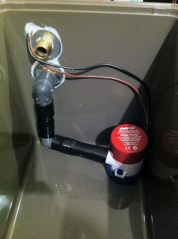

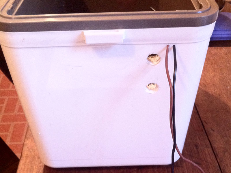

It was then time to drill some holes into a brand new airtight cooler. As you can see, the holes for the wires are very very snug. The holes for the pipe fittings were equally tight and needed to be opened a bit to get the parts through. I measured to ensure there would be enough space for the washers and tried to keep all the connecting points as high as possible.
http://dorkiphus.net/porsche/attachm...chmentid=27552
I then did a test fit with everything.

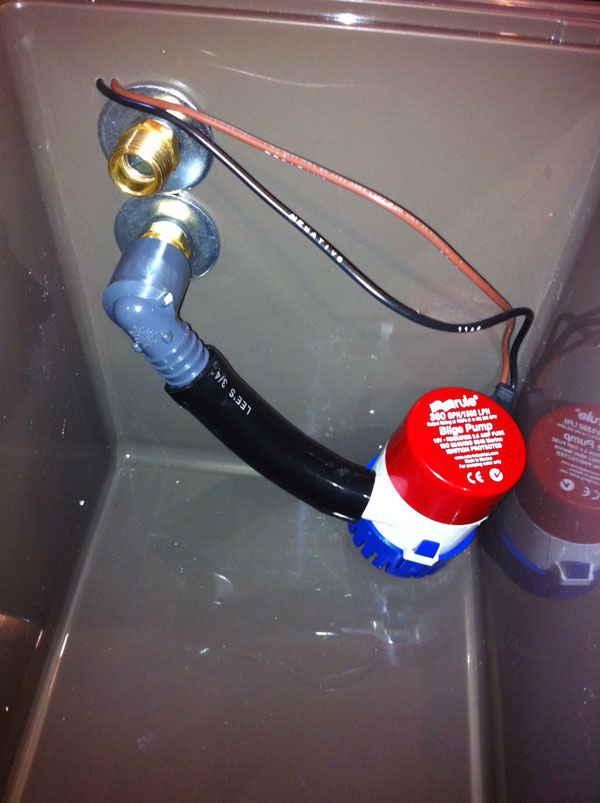

http://dorkiphus.net/porsche/attachm...chmentid=27553
http://dorkiphus.net/porsche/attachm...chmentid=27554
Once I was sure everything looked good, I then started the final assembly. I removed and roughed up the insulation on the inside of the pipe holes to allow for the adhesive silicone caulk/sealant to have a place to bond to. The main concern is water running between the washers and getting into the innards of the cooler itself.

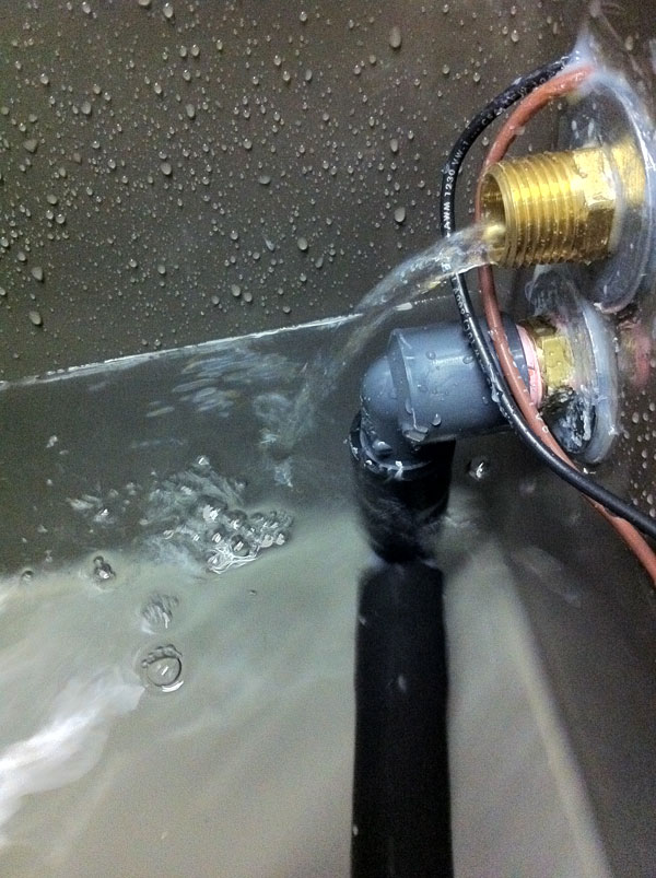

Now I put a bunch of caulk all over the inside of the wholes and the area where the washer would be touching. I also put a little around the pipe before putting the washer on. It was just a matter of wrenching it all down in place. I did not use any caulk on the outside fittings, but did use the pipe thread everywhere. Here is the completed cooler.

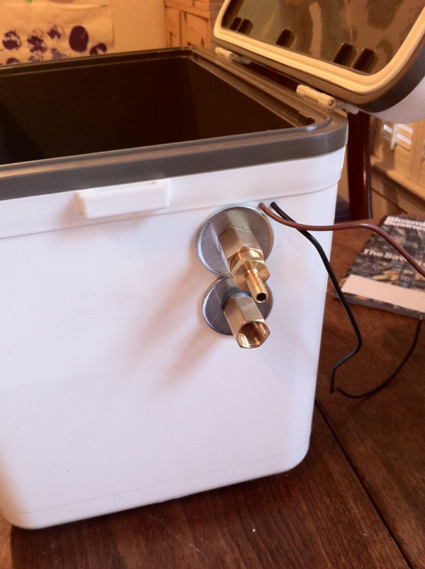

http://dorkiphus.net/porsche/attachm...chmentid=27548
http://dorkiphus.net/porsche/attachm...chmentid=27549

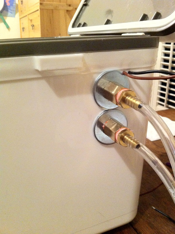

And here it is running!
http://dorkiphus.net/porsche/attachm...chmentid=27555
I'm very happy with the final results. The flow is great and this is with the shirt hanging 4 feet above the cooler. I used the 3/8 inch coupler so I can later remove the barb fitting and install one of the threaded CPC connectors.
