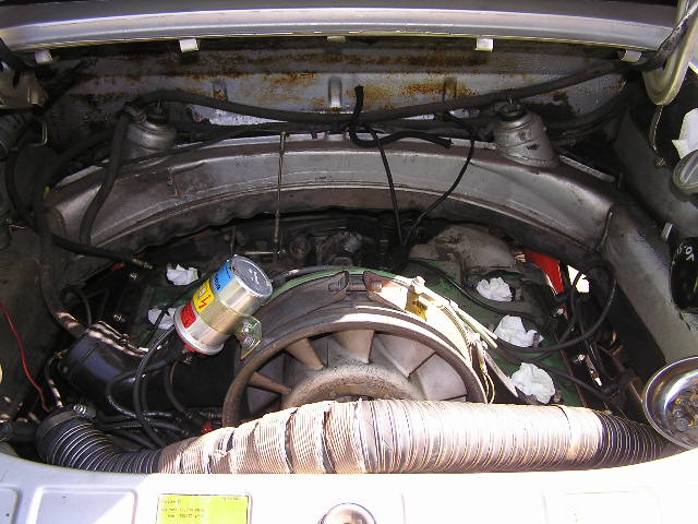

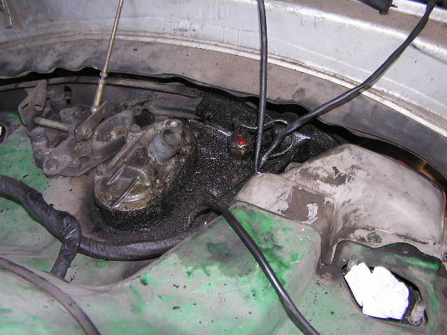

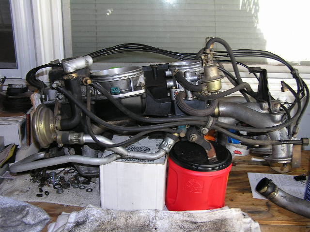

Jase007 09-18-2007 11:16 AM
3 Attachment(s)
IMA is a good place for the injector cleaning. :)
You've inspired me to take the CIS apart on my '76 for some air / oil leaks:
Attachment 7720
Attachment 7721
Attachment 7722
Rick Lee 09-18-2007 11:18 AM
It taking my intake off were that simple, I'd do it too. Pulling my engine requires an alignment afterwards. I'm probably headed for a smoke test and injector cleaning.
