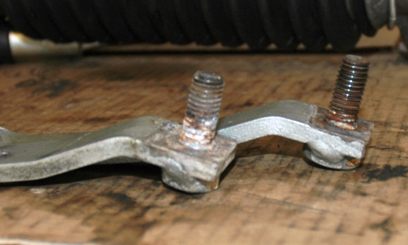

First, some pictures from yesterday. I was too burnt out last night to post them. First is a lesson in metallurgy. What happens when two dissimilar metals like steel and aluminum are in contact with each other for, say, 22 years? Electrolysis and corrosion. I think the former leads to the latter, but WTF do I know? I'm an EE not and ME.
Attachment 6158
Anyway, here are the AL crossmember support brackets. On most cars they hold the under body sway bar. You have to remove them to remove the steering rack. Mine were stuck, and good. In fact, the first time I redid my suspension, I thought these brackets were welded into the crossmember. Some heat and a BFH got them out (DR would have been proud). I guess this is what anti-size helps prevent.

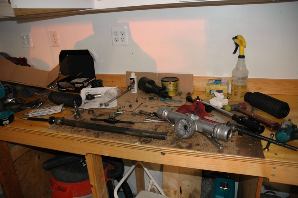

Here a picture of my steering rack mid-clusterf**k:
Attachment 6159
The helicoil was successful in recreating threads so I could reassemble the rack. The process of installing the helicoil was successful in filling the rack with shards of aluminum. Sweet! Now I get to completely disassemble the rack, clean it and regrease! I think the only thing that didn't send me over the deep end with this was the fact that I had been to SPE (Matt DeMaria's shop) earlier that day and, one the way home, passed a bike shop. Thinking about the steering rack, I ran in on a whim and bought a 32mm headset wrench, which is perfect for removing and installing turbo tie rods. Remember, this is before I FUBAR'd the threads. In the bike shop I thought "I'll need this one day, might as well get it now". "One day" came a lot sooner than I thought. Dammit. :XX

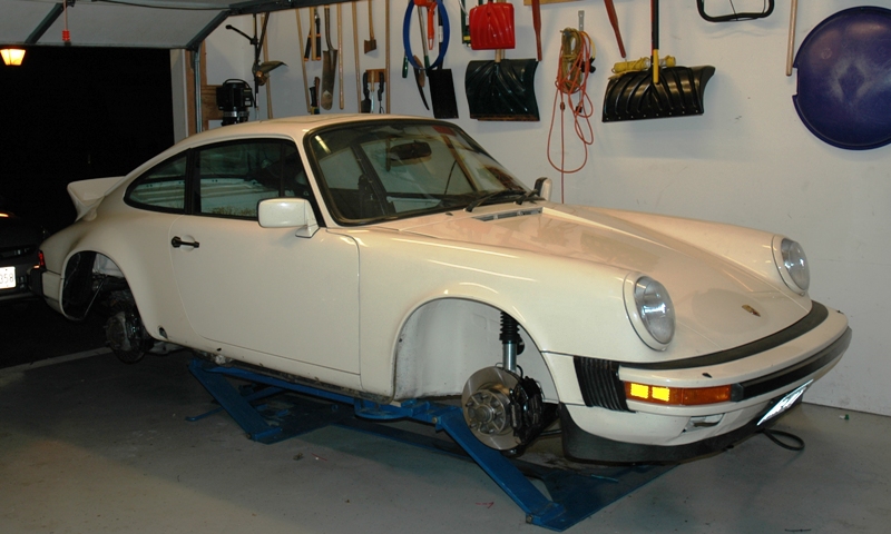

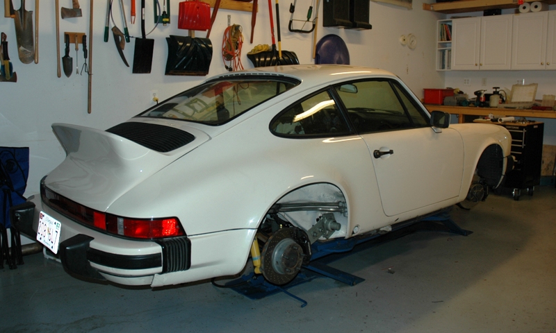

So here's the car now:
Attachment 6160
Attachment 6161
